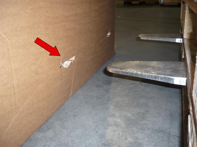

A common problem in organizations where several different pallet sizes are used, for example in the packaging, paper, beverage, automotive and furniture industries, is that it is hard to find the optimum length of forklift forks because they are either too long or too short. If the forks are too long, they will protrude through the rear of the pallet when they are being inserted into it and catch any load located behind it when they are raised. This will damage the pallet and possibly the product, and in the worst case, someone could get injured.
If the forks are too short, there is a real chance that the pallet and load will not be sufficiently supported, causing them to topple forwards off the forklift. Both cases will result in costs being incurred (damage, delays, administration, repackaging, etc.).

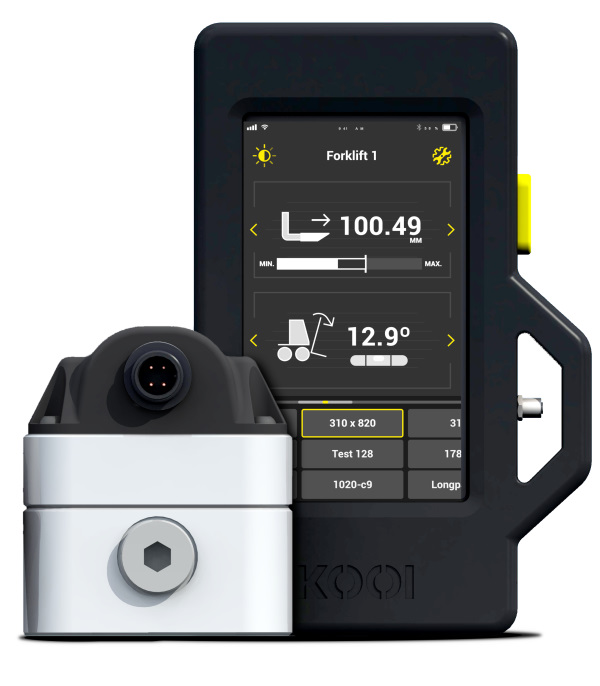

Since the beginning of this year Meijer Handling Solutions has introduced its KOOI® ReachControl; a patented system that includes a flowmeter (base unit 100x80x60 mm -3.93x3.14x2.36) and an app to operate the system. As the name suggests, this flowmeter can detect the amount of oil flowing through the reach forks. Specially developed software can be read using an app that is compatible with standard Android or iOS smartphones. The more extensive version of the KOOI® ReachControl features the ability to stop the outer sleeves at certain set lengths (at least 8 pre-sets).
Customers can enter the variables themselves and allocate a specific name to each setting. The system can be mounted on any telescopic fork as no modifications to the reach forks are required.
Without the automatic stop function, the system can be rapidly installed and information is transmitted by means of a Bluetooth® signal. The KOOI® ReachControl system is also fitted with a tilt indicator as standard so that you can immediately see that the reach forks are being inserted horizontally into the pallet openings. After all, if the forks are not horizontal when they are being inserted, they will damage the deck of the pallet. The tilt indicator can also help improve handling cycle time by allowing the lift truck operator to work faster as the operator always know if the forks are level prior to entering into the pallet.
The auto-stop system features a special valve. In addition, a power supply is required because otherwise the battery in the KOOI® ReachControl would run down too quickly.
Although the app can be downloaded to any modern smartphone (iOS/Android), Meijer Handling Solutions recommends purchasing the specially developed 5" color monitor because this can be connected to an external power supply and features a sturdy casing. The KOOI® monitor can also be operated while wearing most commonly worn work gloves, and when used in conjunction with KOOI® ReachControl, it offers one of the most innovative solutions in the field of pallet damage prevention.
