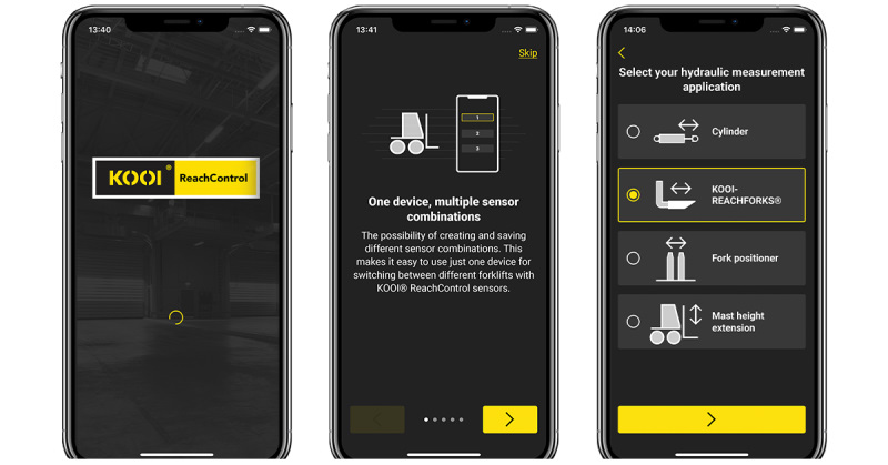

Since the beginning of this year Meijer Handling Solutions has introduced its KOOI® ReachControl; a patented system that includes a flowmeter (base unit 100x80x60 mm -3.93x3.14x2.36) and an app to operate the system. As the name suggests, this flowmeter can detect the amount of oil flowing through the reach forks. Specially developed software can be read using an app that is compatible with standard Android or iOS smartphones. The more extensive version of the KOOI® ReachControl features the ability to stop the outer sleeves at certain set lengths (at least 8 pre-sets).
Customers can enter the variables themselves and allocate a specific name to each setting. The system can be mounted on any telescopic fork as no modifications to the reach forks are required.

Although the app can be downloaded to any modern smartphone (iOS/Android), Meijer Handling Solutions recommends purchasing the specially developed 5" color monitor because this can be connected to an external power supply and features a sturdy casing. The KOOI® monitor can also be operated while wearing most commonly worn work gloves, and when used in conjunction with KOOI® ReachControl, it offers one of the most innovative solutions in the field of pallet damage prevention.

  • Programmable by mobile app (Android / iOS)
  • Free choice in numbers of pre-sets and naming
