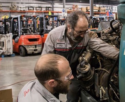

Make sure to schedule regular maintenance
