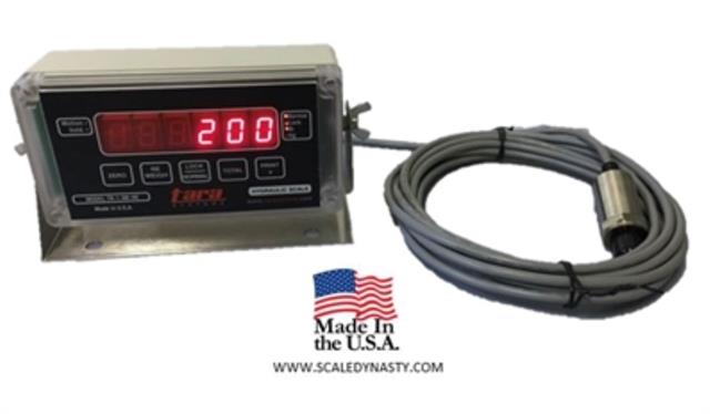

Turn your forklift into a scale with our on-board hydraulic forklift scale made in the USA! Our full feature forklift scale works with forklifts, front end loaders, skid steers, tractors, and most machines that have a hydraulic lifting system. Our forklift scale allows you to lift the load and read the weight in the same process and is built with a water-resistant corrosion proof enclosure that can withstand any type of environment from snow, wind, rain, and direct sunlight. This system has an accuracy of 98% or better!
FEATURES:
  • 5000 PSI (temperature compensated) sensor. For harsh environments and extreme temperatures.
  • Accuracy error is +/- 1-2% of lift capacity.
  • Visual Overload alarm - adjustable alarm to "visually" alert and warn the operator of potential overload problem
  • The scale's capacity has no limit and will be the same as the machine's capacity.
  • Display mounted for easy viewing and operation without interfering with the operators view.
  • Highly efficient super bright LED display. 6 digits .56" high.
  • Water-resistant, corrosion proof, display enclosure with stainless steel adjustable stand/mount. ABS Sealed. Measures 6.5" x 3.5" x 2.25" without stand.
  • Weight totalization feature. Can add multiple loads for a total weight. Allows for accumulation when loading or unloading. Each weight can be stored and totaled.
  • "Lock-on-Weight" feature that keeps the weight on display.
  • A "reweigh" button for "lock-on-weight" to recall weight without reloading the scale.
  • Adjustable motion detection and threshold for "lock-on-weight".
  • Adjustable sample weight.
  • Display modes for current load or total weight.
  • Full range push button zero, tare.
  • Tee fitting is not included and can be found at your local parts store. 1/4 Inch NPT male threads on sensor.
  • Installation: 60-120 mins approximately.
  • Graduation: Weighs in 10lb increments up to 10,000 lbs. and 50 lb. increments above 10,000 lb. capacity.
  • Powered off the machine battery. Comes standard 12v. For electric forklifts with a power of (24v, 36v, or 48v) please choose appropriate converter at checkout.
  • 12 Feet of cable for hook up.
  • A known weight load of at least 10% capacity should be used for final calibration on site.
  • Adjustable parameters for automatic weight capture and capture and add for front-end-loaders.
  • Humidity: 0 to 80% non-condensing.
  • Sensor operating temperature: -40c to 125c (-40f to 257f).
  • 60,000 internal resolutions.
  • 1-year MFG warranty.
  • Not legal for trade.
