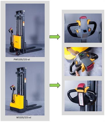

The STAXX Multifunction Intelligent Handle can save your business time, labour and service costs. STAXX Multifunction Intelligent Handle is available on light duty full electric stacker PWS-i and WS-ei Series.

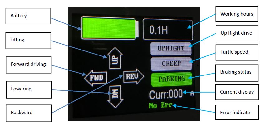

I. Vehicle operation status display
II. Quick Error detecting
III. All maintenance information visualized
IV. Turtle Speed function
V. Up-right driving function
Operation status display
Showing real-time working status : GREEN indicates the function is active.

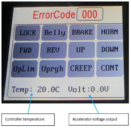

Engineering interface
How to enter Engineering interface:
Under operation status display interface, press and hold the Turtle button for 10 seconds;
Press and hold the Turtle button for 10 seconds to return to the Operation status display interface.
Signal indication : GREEN indicates the function is active.
a. LOCK: Interlock switch status
b. Belly: Emergency reverse switch status
c. BRAKE: Electromagnetic brake status
d. HORN: Horn switch indication.
e. FWD: Forward driving status
f. REV: Backward driving status
g. UP: Lifting status
h. DOWN: Lowering status.
i. UpLim: Lifting height limitations status
j. UpRun: Up right drive status
k. CREEP: Turtle speed status
l. CONT: Contactor status

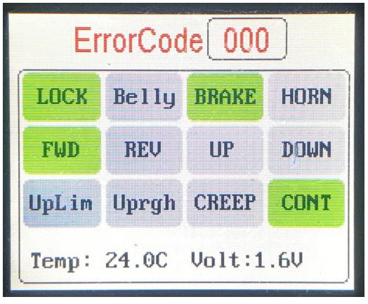

1. Instruct customer to shift screen to Engineering Interface on phone.
2. Error code display on handle can diagnose failure easily and quickly.
3. Ask customer to push throttle forward and backward.
4. In below picture shows: LOCK, FWD/REV, BRAKE, CONT. if any icon is not in Green when operating forward, it means that part is broken or faulty.
5. Diagnose the problem and broken parts quickly and easily, take the parts or send the parts to customer for replacement and solve the problem.
