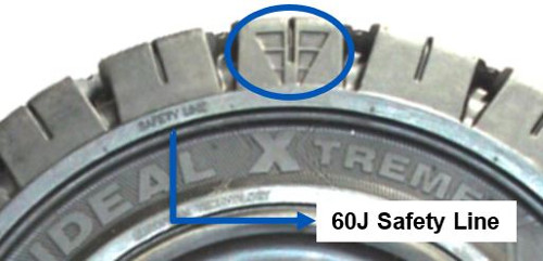

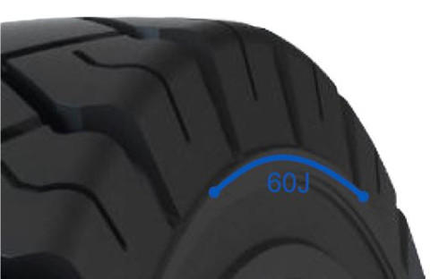

When to replace a Resilient tire
  • Undamaged resilient tires can be worn down to the 60-J line as indicated on the sidewall of the tire.
  • Wearing beyond the 60-J line represents a safety hazard and can lead to unexpected tire failure as well as potential damage to the forklift truck.
  • Certain Solideal branded tires also feature a wearing indicator
