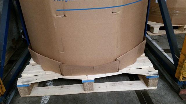

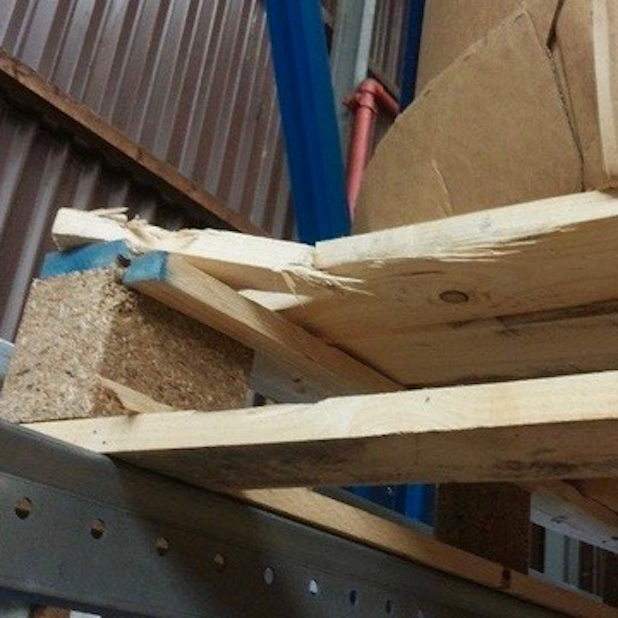

While doing a safety tour of the site, Arends was struck by the number of damaged pallets at Compound. Despite lowering the maximum driving speed for forklift trucks, the forks often hit the pallets so hard that the lead board o the upper pallet deck was damaged. The board cracked or broke, leaving splinters or sometimes even entire pallet elements on the ground. Such damage reduced the pallet's load-bearing capacity and could even result in damage to the goods. "Our bulk containers always bulge a little when they are on the pallet, and then you touch them with the fork back", says Arends as he points to one of the units. "You only have to have the mast leaning forward a bit when picking up a pallet to pierce the top of the package and damage it. Of course, you don't want that any more than we want splinters in the product when we rotate pallets to empty the packaging during the production process. For that reason, we had all the damaged pallets repaired, and even had to replace the packaging regularly."

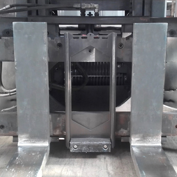

Bert Arends found the solution to this long-running problem from Klaas Schepers, Director of PalRoRo, which is marketing a plastic pallet bumper in the Netherlands. This PVC unit is applied to the carriage plate to hold the pallet slightly away from the heel of the fork, do that the fork back does not touch the lead board. During an initial trial deployment, the advantages and disadvantages of the plastic pallet bumper were exposed. "It's a good system, but just a little too one-sided as regards its size and possibilities", Bert Arends continues. "So Klaas looked for an improvement and developed his own pallet bumper. This gives even better protection and makes the product more widely usable."
The Pallet Bumper consists of a solid steel frame that matches the size of the forklift truck's carriage plate. This means they fit on all commonly used carriage plate types, normally from 2A to 3B. The frame incorporates at least one and sometimes two blocks of synthetic material. The size of the block can be adjusted to the situation it is used in, which means the bumper can offer protection for various pallet types with a variety of top boards and spacer blocks, and loads which may or may not overhang.
