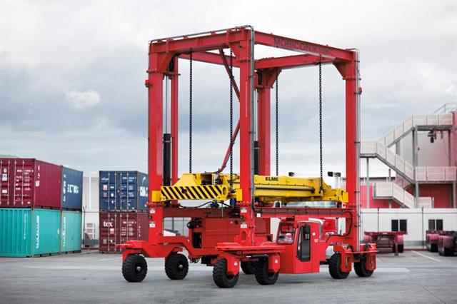

Tom Schults, Managing Director Of Mobicon Mini Straddle Carriers Said;
"In the 20 odd years that Mobicon have been making Mini Straddle Carriers, I have never known a client who takes the view on maintenance 'If it's not broken, it'll be fine', to come out on top in the cost department. While it may save money in the short term to skip maintenance checks, it will always end up costing them more in the long run'.
'The advantages of preventative maintenance checks include: improved reliability of the machine, less downtime during the busiest and often most profitable time for the business, improved safety, and lower overall M & R Costs. A machine that is regularly well maintained will also last longer, and is more cost efficient".
Mr Schults continues;
"Another question we also ask at this time of year is, 'Does the container handler we currently use best fit our purpose, and it is right for our yard?'
'For example there could be an alternative machine on the market that can do the same job, and will be more efficient to run in terms of costs, such as petrol or tyre replacement which leads to huge savings over a year.'
'Fully understanding what a machine will cost your operation in the long term should always be considered. So often we talk to clients who like the look of machines with a three wheel design, however the reality is the concrete in their yard is not designed to take the weight of a three wheeler, and within months (sometimes only weeks) they would be looking at a huge bill to fix their foundations as the machine has made a mess of the yard. Knowing what options are available and are suitable, can save huge repair bills and the cost of downtime when a new yard has to be laid".
Although most of the maintenance tips below are common sense, spending time on preventative maintenance is best practice from a cost perspective and safety point of view.
Below is a checklist for operations to consider to ensure a profitable lead up to Christmas.
General Maintenance
  • Servicing the Engine - Oil, Fuel, Air Filters & Change Sump Oil
  • Check the Engine Fan Belt for tension and check for wear. Replace if needed
  • Grease all Nipples and Gliders - refer to the operators manual for instructions
  • Catch up on any outstanding repairs
  • Wash Down The Machine - operators tend to treat tidy equipment better!
Tyres
Check your tyres for excess or uneven wear. Wheel rotation (Front to Rear on each tower) is the perfect way to extend your tyre life and ensure even wear. Also check the wear does NOT exceed the wear line on the tyre.
Electrics /Systems
Check that all of the operational & warning lights are functioning correctly. Also check the camera system for any faults.
Hydraulics
Keeping the moving parts of any machine well-lubricated is essential:
  • Fix any oil leaks
  • Ensure all hoses are well secured
  • Book in a system oil sample test (inexpensive test $35 + postage - could potentially save thousands)
Operators
Are all of your operators trained properly to operate your container handling machine? Are they driving/treating the equipment in a way that will ensure the most efficient performance from the machine?
