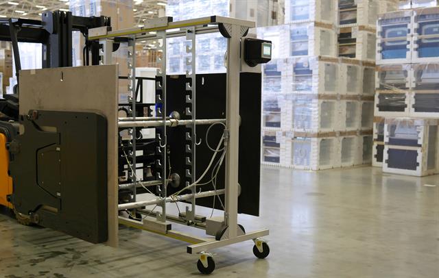

The correct equalization of the clamping force over the surface of the pads is a key factor for home appliance and carton clamps to ensure a safe and damage-free handling of white and brown goods.
Forklift attachment manufacturer Bolzoni Auramo will soon release the 4-Point Clamping Force Tester, the optional equipment specifically designed to grant the correct factory set up of the home appliance and carton clamps.
4-Point Clamping Force Tester_measurement on pad
At the end of the production line all Bolzoni Auramo carton clamps are tested with the 4-Point Clamping Force Tester to ensure the correct ratio of clamping force over the pads. After a certain period of use the 4-Point Clamping Force Tester allows customers to check the efficiency of their clamp, measuring the clamping force distribution over the 4 points of the pads and recalibrating the toe-in if necessary. The equipment - based on precise load cell technology - is able to measure the single force acting on each point, to calculate the total clamping force developed on the whole pad surface and to detail the exact percentage of the force acting on each point. The user friendly LCD interface allows to save all the data on a USB memory stick. The portable structure on 4 wheels can also be moved with pallet and van, allowing multiple uses in white and brown goods production and logistics centers.
The 4-Point Clamping Force Tester includes:
  • Modular design with measurement bars to check the clamping force at different opening ranges
  • LCD display with touch screen technology
  • Multilanguage communication system
  • Heavy duty cart design
  • Lower frame on high resistance polyurethane wheels - two with brakes
  • Easy assembly and reduced weight thanks to aluminum bars
