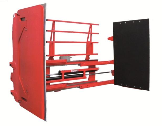

The clamp includes the technical features of the new conventional carton clamp KS-C model, such as:
  • Very rigid frame structure with single
    piece double "T" profile. Wide visibility
    Carton & Appliances Clamp KS-C model
    window thanks to new vertical plates position at the extremity of the frame. Narrow vertical plates. Superior visibility through the frame grants safe and easy handling operations.
  • New aluminium arm design with new high friction rubber lining, special Bolzoni design.
  • New check valve for simple and precise arm synchronism, easy fitting, new position in the upper profile shadow granting valve protection and high visibility of the structure.
  • New fixing system of the sliding pads
    to relief stress.
  • New self-aligning cylinder fixing to avoid breakage.
