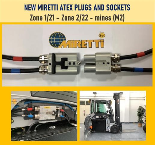

The new plugs and sockets can be used in both Category 2 (Atex Zone 1 and 21) and in Category 3 (Atex Zone 2 and 22). They are also suitable for use in applications connected to mines / subsoil (M2) meaning a wide range of use can be confirmed for this new product.
Those who are worried about dimensions and poor ergonomics of the traditional plugs will certainly be satisfied with this solution devised by Miretti which proves to be a lot less invasive as well as highly performing. In fact, the new plugs and sockets are extremely compact systems. Therefore, they can be easily mounted even on trucks and on machines where spaces are extremely limited.
The new system is easy to use for the operator who, through a simple and unique operation, can simultaneously disconnect both the positive and negative poles in a simple and quick way, avoiding complex and complicated extraction operations, which is what happens with current battery connectors.
In addition to those features, the new plugs and sockets boast a great quality execution with the use of sturdy, durable but at the same time light materials since the anodized aluminum alloy for Category 2/3 and brass for Group I M2 have been used.
The implementation of a one-way locking device, the bipolar instead of unipolar connector, the extraction handle instead of the rotary release are pluses designed for the user. The chosen material also increases resistance to corrosion and wear.
