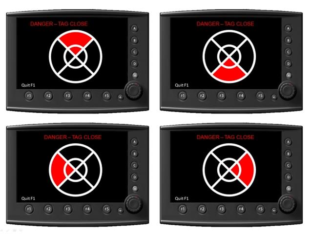

NearGuard consists of a minimum of two sensors that are mounted on the lift truck, one at each end of the truck, and RFID tags. The tags can be attached to a wide range of customer-defined subjects including work clothing worn by employees, other items of mobile operating equipment, or stationary obstacles. Once a tag is located, NearGuard activates a radar-like screen that gives drivers a clear visual indication of the direction and proximity of any RFID tag within range of the machine. The system engages at a range of 50 meters.

NearGuard's radar-like screen warns drivers when an RFID tag is within range. At left: tag detected, four quadrants. At right: tag too close, four quadrants. Click for larger image
