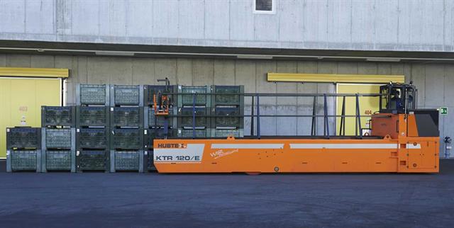

KTR 120 apple crate transporter has a load carrying capacity of 12 tonnes and can pick up seven batches of up to four crates.

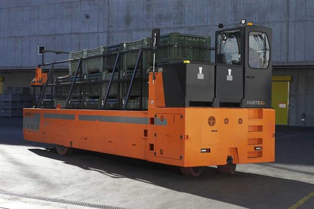

At 10 metres in length and 2.40 metres in width, the vehicle is also able to drive through the side aisles right up to the cold storage units.

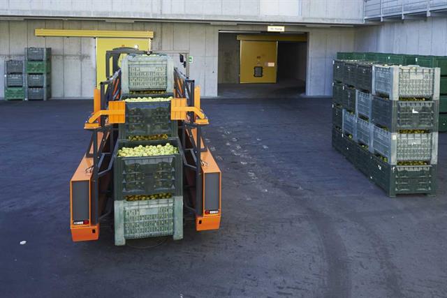

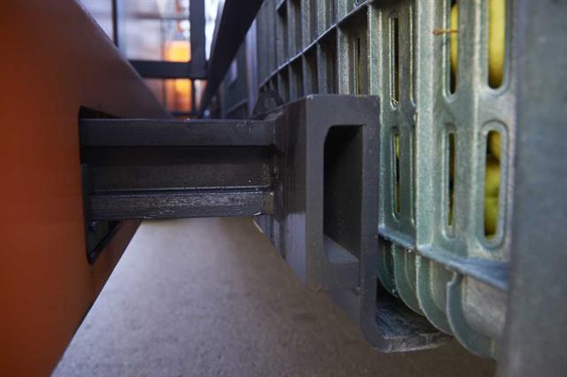

The load is picked up via a synchronous lifting of the chassis using a lifting rail. Each batch of crates is gripped and lifted by a fork in the wheel arms.

Working to the requirements of the apple growing cooperative, Hubtex developed the KTR 120 inloader, which MIVOR has been using since June 2016. The apple crate transporter has a load carrying capacity of 12 tonnes and can pick up seven batches of up to four crates. It can also transport up to 144 crates per hour. In addition, Hubtex fitted the vehicle with a battery-powered drive to comply with the cooperative's hygiene requirements. The inloader can cover distances of up to 50 kilometres per day thanks to its two large lead-acid batteries. At 10 metres in length and 2.40 metres in width, the vehicle is also able to drive through the side aisles right up to the cold storage units. The load is picked up via a synchronous lifting of the chassis using a lifting rail. Each batch of crates is gripped and lifted by a fork in the wheel arms, meaning the use of additional transport pallets is no longer required. The sensitive loads are also carefully secured during transport. Two hydraulic clamps keep the apple crates fixed on the KTR. Upon arrival at the sorting facility, the driver sets down the crates on the floor without any assistance required. When returning to the cold storage units, the driver takes back the empty crates, with the number of required trips minimised further. Vehicle ergonomics have also been improved: Whereas employees in the past often had to drive in reverse due to the confined spaces created by the tractor being used, the driver now sits at a 90 degree angle to the direction of travel in the KTR. 'Since we have been using the KTR, our working processes have become considerably more efficient and also more flexible,' reports Wellenzohn. As only one employee is needed for transport and an additional worker for setting up the crates in front of the cold storage units, personnel resources can be deployed more efficiently. 'We are now able to better manage peak periods while the driver of the apple crate transporter can also regulate the material flow by leaving empty crates on the return trip, for instance.'

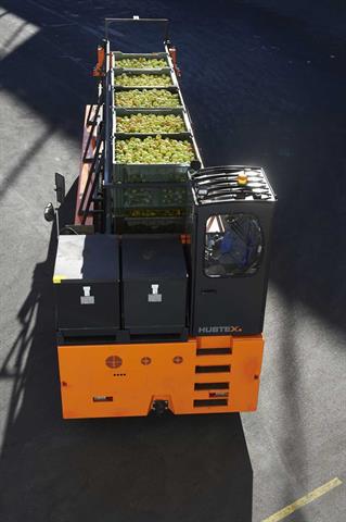

The driver sits at a 90 degree angle to the direction of travel.

Sensitive loads are secured during transport by two hydraulic clamps.
