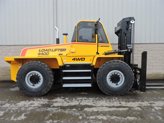

Load Lifter Manufacturing Ltd., Stouffville, Ontario, Canada, has rolled out a new model in its heavy-duty range of vertical-mast, rough-terrain forklifts.
The 4414-25F is a rugged, 25,000 lb. (11,300 kg) capacity forklift that features four-wheel steering and full-time four-wheel drive.
Excellent ground clearance and gradability make it well suited for work in poor ground conditions and remote areas.
Typical applications include lumber and sawmill work, pipe handling, oilfield work, mining, and steel fabrication.
It is powered by a 174 Hp six-cylinder Perkins electronic engine coupled to a Dana 32,000 series transmission and Kessler heavy-duty outboard planetary-drive axles complete with full-power hydraulic brakes.
A fully enclosed, isolated operator's module comes standard and includes adjustable tilt steering, seat-mounted ergonomic controls, full suspension seat, front and rear wipers and a ducted heating system. The seat location gives the operator a superior view of the job site.
A full range of mast lifting heights is available, as well as a full range of OEM attachments, such as pipe clamps, spreader bars, and grapples.
