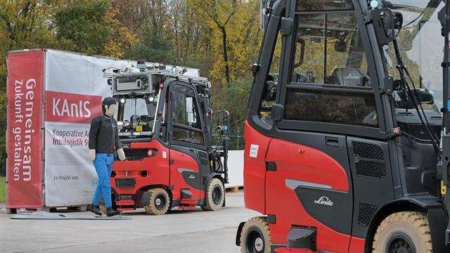

A crash test dummy was used to test the technology

A particular focus of the research project was on the automated forklifts’ perception of their surroundings in order to ensure their reliable interaction with other road users.
Part of the testing involved a crash-test dummy that suddenly emerges from behind a wall and runs into the forklift’s path.
