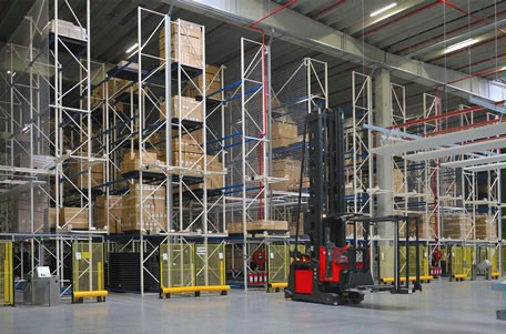

Linde's K Range high rack stackers are fully automatic and travel on wire along the aisles.

In the warehouse's new storage area for the slow rotation of Samsonite products are three Linde K Range automatic high rack stackers that move both freely and on wire guidance. E&K Automation partnered with Linde Material Handling to equip the trucks with a laser camera, telescopic forks and pallet profile control.

The automated K Range trucks are normally wire-guided along the aisles. Each of the racks has a 150mm (5.9 inch) safety clearance between the truck and the load in the rack. Movement of the truck outside of the aisles is via a laser scanner system. The laser guidance system works by using reflectors located in the warehouse.
