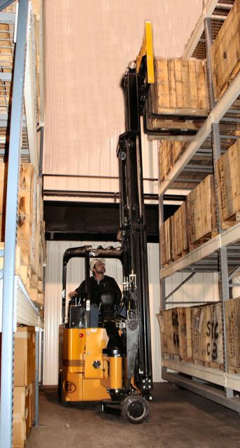

The Landoll Corporation Bendi 180 degree articulating electric forklift now officially has entered the Very Narrow Aisle marketplace. This market is defined as customers having storage aisles 6' (1.8M) wide and under with loads 48" (1200mm) long x 40" (1000mm) wide. Up until recently the Bendi was limited to aisles of 78" (1.98M). By redesigning the front axle to make it narrower and thinner and by designing a mast that has a narrower profile this 6" (150mm) aisle reduction was achieved. Called the "N" Series it has all the same rugged design features of the standard Bendi Series IV including dual independently driven rear wheel drive systems. Lift heights from 198" (5.03M) to 272" (6.91M) and capacities of 2,500 lbs. (1136kg) and 3,500 lbs. (1591kg) are available. Working in this narrower aisle opens many doors to the Bendi that were previously closed. This includes working in most standard Turret Truck aisles either as a direct replacement or as a supplemental vehicle. The Bendi's ability to perform all the normal duties of a front loading counterbalanced forklift and now operate in Very Narrow Aisles without a guidance system makes it the most versatile VNA machine on the market today.
