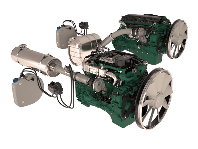

Volvo Penta D5 and D8 Tier4F engines with SCR system - Click for larger view

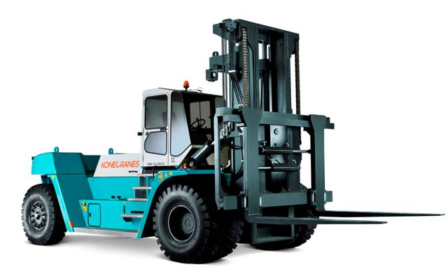

The Auto Start-Stop feature turns off the engine whenever the lift truck idles for a period of time and restarts it automatically when needed. The saving principle is simple. When the engine does not run, it does not consume fuel.
The Konecranes Auto Start-Stop feature turns off the engine when it is not needed. When the lift truck is idling, you put it into neutral and take your foot off the brake pedal to activate the function. "Start-Stop" then appears on the info (MDL) display, the engine shuts off after a few seconds, and the parking brake will automatically engage. To re-start the engine, simply press the brake pedal. If the lift truck is stationary but power is needed for lifting, touching the lifting lever or joystick will automatically re-start the engine.
Safety is not compromised
Driving comfort or safety are not compromised by the function. Working lights, cabin ventilation and heating, as well as safety functions will continue to operate during automatic engine stoppage. Auto Start-Stop will not activate until the engine has reached operating temperature and will always ensure to keep the battery charged for the next engine re-start. The Auto Start-Stop function is controlled by a central control unit that monitors data from relevant sensors. The control unit will automatically restart the engine when the driver presses the brake or drive pedal, or if the battery state of charge drops too much. Pressing the brake pedal will release the parking brake as well, but this can also be done by undoing the parking brake switch.
The Auto Start-Stop system recognizes the difference between a temporary stop and the end of a job. It will not restart the engine if the driver's seatbelt is undone, if the cabin door is open, or if the engine stoppage time has exceeded a preset time-out value.
Konecranes offers heavy duty fork lift trucks with lifting capacities from 10-65 tons - Click for larger view

Konecranes Lift Trucks have developed the Auto Start-Stop function in cooperation with Volvo Penta. The Auto Start-Stop function is available with selected Volvo3B/Tier4i engines, as well as with all coming stage 4/Tier 4f Volvo engines.
