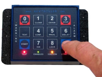

START-SMART is a simple extremely rugged keypad ignition system that is used on variety of vehicle applications. The device is available in a code only or a code and RFID card reader version. The device will fit to any make or model vehicle be it electric, gas, LPG or diesel and is designed to keep untrained and unauthorized operators from starting the vehicle. START SMARTS have been installed on wide variety of equipment like forklifts, electric jacks, skid steers, backhoes, cranes, personel carriers, golf carts and even military Humvees.
STARTING AN ENGINE OR ELECTRIC MOTOR
After enabling with a valid code or RFID card, the operator can start and stop the engine directly from the keypad eliminating the ignition key completely - NO MORE lost, stolen or broken keys! Once enabled, the driver starts the engine by pressing the START button which engages both the ignition and starter relay - in the case of an electric vehicle only the ignition relay is used to power up the vehicle. Once the vehicle is started, the operator removes his finger from the keypad and the starter relay drops out (IC vehicle only) and the ignition relay stays engaged. To stop the vehicle, the operator presses the STOP button or disengages a seat belt or gets off the vehicle and the seat or foot switch logs out the device.
INSTALLATION:
START SMART'S small profile 89mmX75mmX20mm (3.5" X 3" X .75") fits easily to any dashboard and the device will fit to any 12, 24, 36 or 48VDC vehicle. The unit consists of 2 components:
  1. A completely weather sealed keypad that is potted with liquid gel to prevent water or condensation intrusion to the PCB board. It is commonly used in freezers and the toughest outdoor weather conditions and temperature extremes.
  2. Dual relay module with in line weatherproof connector to the keypad.
All electrical connections are made at the relay module.
  1. 2 wires to power (12VDC or optional voltage converter for 24, 36 or 48 VDC vehicles)
  2. 3 wires to ignition switch (for IC vehicle - power, ignition and start) or 2 wires (for EL vehicle power and ignition)
  3. 1 wire to auxiliary input (seat switch, seat belt etc)

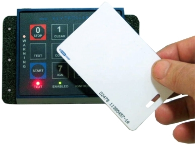

START SMART is unique in that user codes or RFID cards can be installed or removed in two ways.
  1. By using a PROGRAMMERS code or RFID card and using a sequence of keypad presses to insert (or remove) the operator's code/card credentials.
  2. By using START SMART PC software which will allow the programmer to create a user database for all the drivers codes, RFID cards and expiration dates. The programmer simply checks the appropriate drivers for a unit and presses the PROGRAM button to insert all the drivers at once.
