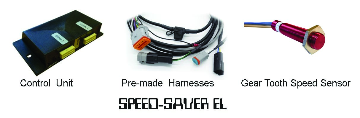

Speed Saver EL components
SPEED SAVER EL kit comprises the following as core items:
  • The Control Unit.
  • The relevant cable harnesses (if make/model forklift is included with order)
  • Fitting equipment.
  • Installation manual.
  • Software Disc or Stick
  • An itemised list of all the parts supplied
  • In addition to the core items the kit supplied may also include:
    • Magnetic pick up (MPU) speed sensor.
    • Loose Deutsch connectors for fitting to the trucks harness.
    • Mounting brackets for either the MPU or the Control Unit.
    • Bespoke interconnection documentation which could include guidance installation photos and truck specific schematic diagrams.
    • Prior to fitting please ensure, using the itemized parts list, that all the components are present.
