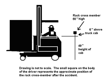

Many stand up forklifts are built such that the operator compartment is open at the back; there is no protective structure reaching from the overhead guard to the forklift body. The operator is exposed if the forklift reverses into racking. The forklift body can ride under a horizontal rack beam, crushing the operator. See the illustration below.
Source: OSHA, Stand-up Forklift Under-ride Hazards, Safety and Health Information Bulletin, SHIB 07-27-2009
