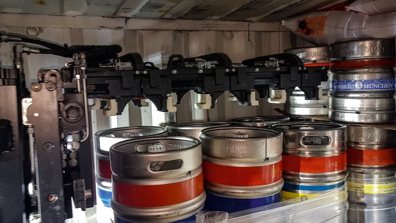

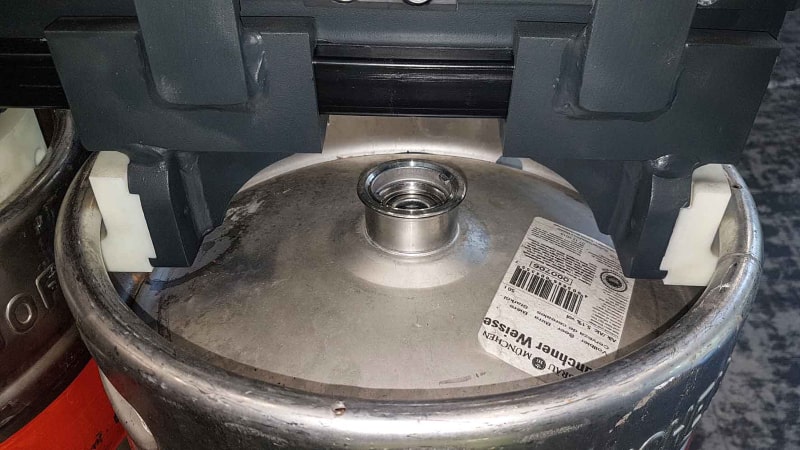

The solution for the handling task at Hofbräu München is both simple and complex. As the kegs are not transported on pallets, the conventional attachments - fork positioners and multi-pallet handlers - are out of the question. Likewise, clamps, mainly drum clamps and keg clamps, cannot be used because the required number of kegs could not be placed in the container to be loaded. Therefore a special solution is needed to master the task. A special solution that grips the load from above - i.e. head first.
KAUP has developed a new type of clamp to pick up the reusable kegs. The main components of clamp 0.5T099 - also known as beer keg gripper - are the six spreading devices with two spreaders each. These devices are arranged on a boom which is lowered onto the kegs from above. Once positioned, the spreaders extend and pick up the load. Inside the container, the forklift, a Toyota Traigo 48, drives to the designated place, lowers the kegs and releases the spreaders. A fast, effective loading process. The process is additionally accelerated by the sideshifter with increased sideshift stroke 2T151P-C. Why? A special feature of this sideshifter is the ability to move its load beyond the forklift contour up to the wall of the container. As the boom of the beer keg gripper is hooked into the sideshifter, the kegs can also be set down directly at the container wall.
The beer keg gripper has profoundly changed container loading in Munich-Riem. Today a container can be loaded in approx. 90 minutes - the loading time has been more than halved. Only two HB employees are needed for this - previously there were twice as many. And it does not matter how large the kegs are - 50 litres, 30 litres or 20 litres.
