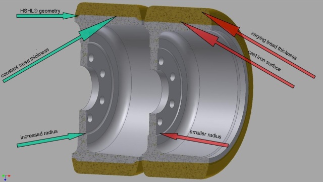

Comparison wheel with HSHL® geometry (left) and conventional wheel (right)
On conventional VULKOLLAN® wheels, tread thickness varies because of the draft angles of the cast iron wheel centres and core displacement. The cast iron surface is not machined.

With the RAEDER-VOGEL® HSHL® contour, uniform tread thickness is achieved through complete machining of the wheel centre. In the thermally critical area tread thickness is reduced. At the flanks, in the areas with the highest load and shear stress, adhesion is improved. Higher material thickness helps to avoid spontaneous tread separation. Together with the transmission manufacturers, we also redesign the wheel centres for greater strength. Mechanical machining and the contact surface are optimised.

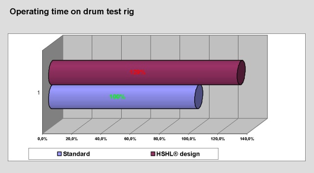

Destructive testing of HSHL® drive wheels for walkie trucks and order pickers on the drum test rig has shown that the service life of the wheels increases by 29 %.

Comparison of operating times until complete destruction of standard and HSHL® wheels
