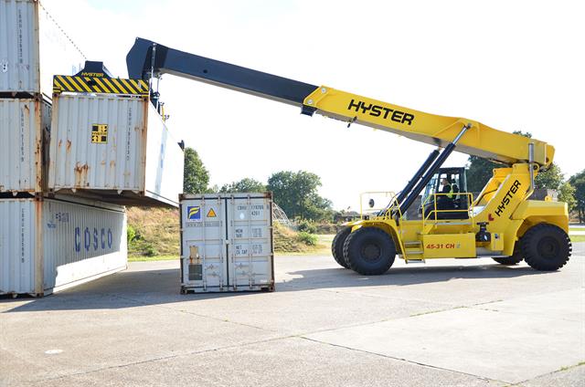

Hyster Company has introduced two weighing systems that can be fitted to Hyster reachstackers and laden container handlers to obtain a Verified Gross Mass (VGM), as required by the recently introduced SOLAS Legislation.
The new Hyster Static and Static Plus systems are quick and easy to use, cost-effective and have limited impact on container throughput.
The systems provide operators with a pre-programmed lift cycle to obtain the VGM. Using a screen display in the cab, the reachstacker or laden container handler operator can quickly input container identification and have a time-stamped VGM attached to it.
VGM data can be saved to a data module or printed using an in-cab printer, and 3G or WiFi options are available on some models to deliver data to the terminal operating system.
The system display can show gross, tare and net weights.
Whether installed to existing Hyster trucks or factory-fitted to new models, both systems are based on hydraulic load-sensing technology, offering low maintenance requirements, and comply with the OIML R51 class Y(b) guidelines.
The Static Plus weighing system is recommended for countries where "Legal for Trade" regulations apply and uses the Trimble Loadrit® L2180 system. Trimble is a global leading provider of onboard weighing solutions for a wide range of applications that maximise productivity.
Introduced on July 1, 2016, the amendments to SOLAS (International Convention for the Safety of Life at Sea) require packed shipping containers to have a verified gross mass (VGM) before they can be loaded on a ship for export.
