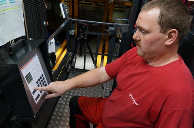

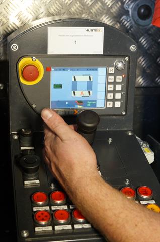

The order-picking process begins with the input of the four-digit storage position which is on the delivery note together with the quantity ordered. Whilst the first digit defines the aisle number, the next two digits indicate the storage rack and the fourth digit the shelf level. The order-picker records the four digits on the large touch panel of the operating platform. The operator then navigates directly and with precision to their target. During this process, the barcode strips applied to the shelf aisles play a central role. Each centimetre of a shelf aisle corresponds to a barcode which is recorded by the reading devices installed at chassis height during the run. If, during the run, the reading device finds the barcode of the desired storage rack, the operator - guided by a graphic display on the touch panel - goes to the correct shelf level with their joystick so that they can begin the removal process from there.
