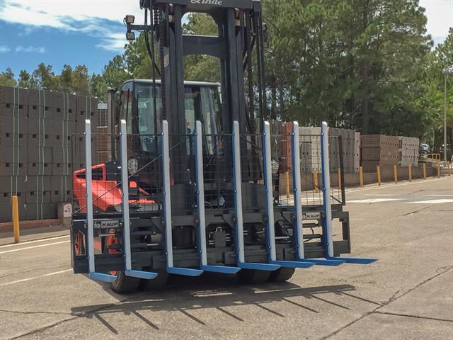

KAUP Australia is the preferred supplier to Austral Bricks. These were usually special pack positioners that were able to pick up and transport four brick packs in parallel. In the course of expanding production, Austral Bricks required KAUP Australia to create an attachment that can transport up to eight brick packs in the future - four packs wide, two packs high.
Together with Austral Bricks and Linde Material Handling Australia, KAUP Australia and the KAUP Australia design department developed a new attachment that meets these requirements at very short notice. The integrated 10T160IPZ fork positioner has been in use on a Linde H120 for the first time in Queensland since early 2018.
Very different factors had to be considered during development. For example, the fork design. A decisive factor for this: they should be designed so that they can be inserted directly into the brick packs. No clamping, no extracting. The forks had to be narrow, short, not too thick and yet stable for this. In addition, the fork backs heights were cushioned so that the bricks are not damaged during handling. For explanation: It is common in Australia that bricks are not transported on pallets but as bound packs. However, two rows of bricks are deliberately left removed in each pack in order to be able to handle the packs. The fork tines push into these openings.
Much more important than the fork design was the special pack positioning design. Each pack needs to move independently. To perform this function the KAUP Australia design team developed a special slide using ball bearings instead of traditional slides. For this reason, the carriage's capacity was significantly strengthened. Each pair of forks now sits firmly on a fork carriage and the reduction in resistance meant the forks can be controlled with a much smaller cylinder. A special design that nonetheless reflects the basic design of the T160IZ: fork positioner with multiple pairs of forks and integrated sideshift. Although the 10T160IPZ is much more complex to implement.
Within 4 months from Austral's request KAUP Australia where able to design, engineer and manufacture this attachment to meet Austral's urgent need.
