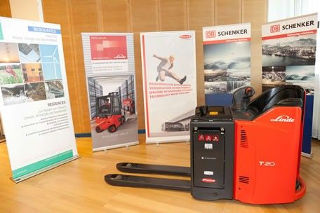

DB Schenker will test the trucks in a field trial this year.
Linde Material Handling is providing 10 Type T 20 SP pallet stackers for the E-LOG bio-fleet research project.
The E-LOG project aims to improve operating behaviour and environmental sustainability by using an industrial truck fleet with a fuel cell hybrid solution and "range extender".
