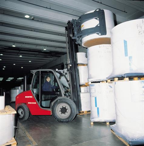

A forklift with a clamp
Neither should attachments be modified to suit a task. For instance, welding a frame onto your forks so that it can act as a tow bar will affect the weight and capacity of the attachment, in turn affecting the rated capacity of the truck. Assess your requirements and, where possible, invest in application-appropriate equipment for tasks carried out on a regular basis.
