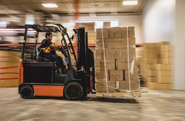

What has changed dramatically in recent years is the frequency that forklifts are being called upon and the intensity of conditions in which they are being operated.
As the space in warehouses, distribution facilities, manufacturing plants and big-box stores becomes even more of a premium, these forklift owners are having to do more with less space than they ever have before. In response to these demands, the lift-and-carry machines they use are being streamlined by OEMs to maximize the limited space available to operate in, through and around.
Today's forklifts are less bulky and less boxy. However, they still have to do the same work as before, if not more, in their modern, more streamlined configurations. Correspondingly, the demands on the tires to meet the heavy lifting demands have increased.

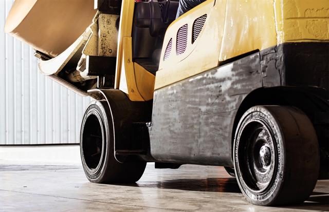

Application intensity reflects the amount of heat stress inflicted on the tires by the forklift's duty cycles. The greater the travel time, the distance covered and the load carried, the more intense the tire's heat buildup will be. At the same time, the required cooldown time will be reduced.
When overburdened, the rubber will liquify, and expand to the point where the tire's sidewalls will fail and the press-on tire will separate forcibly from the forklift. At that point, the machine is down.
