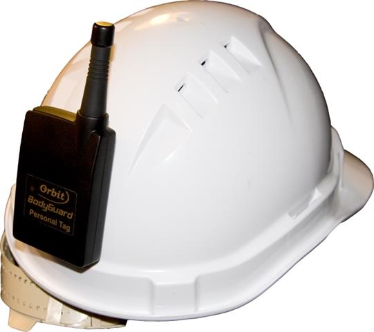

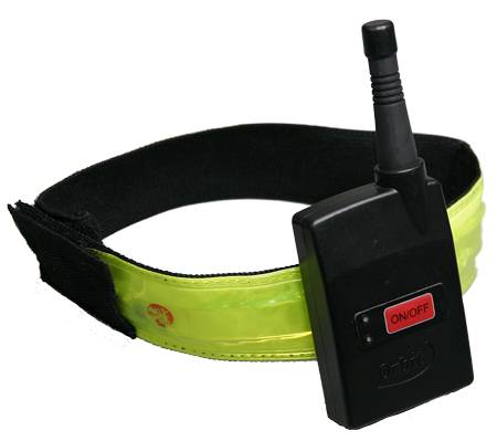

A small transmitter unit (called a "Personal TAG") can be fitted to a hard-hat. The Personal TAG emits a special signal that identifies the type of object (pTAG) and a unique serial number. This enables any equipment, fitted with BodyGuard, to detect and identify any particular pTAG within the programmable proximity safety zone range and activate a visual/audible warning for the driver
of the vehicle.
BodyGuard Personal TAG Unit

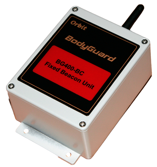

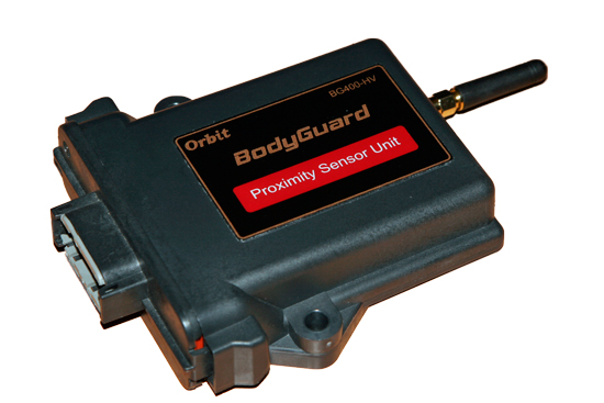

Vehicles and Machinery (Such as Forklifts, Haul Road trucks, utility vehicles, cranes, moving machinery etc) can be fitted with a BodyGuard Sensor Unit. The BodyGuard Sensor Unit can detect proximity to other BodyGuard components (such as Personal pTAGS , Fixed and Mobile Sensors). In addition to detecting proximity to other BodyGuard-objects, the Sensor Unit transmits a specially coded signal that contains the TYPE of vehicle or equipment and its unique serial number.
The Sensor Units can be programmed for proximity safety zone ranges from around 1m to over 100m.Every BodyGuard Unit can be programmed for different proximity safety zone ranges for any objects detected. For example: A Forklift unit may activate a proximity warning for a detected Personal TAG unit at say around 8m but have the range set for ar Forklift unit around 12m.
The Sensor Units have 2 Outputs that can be used to stop a vehicle, slow a vehicle or give external indication to a vehicle management computer or similar.
