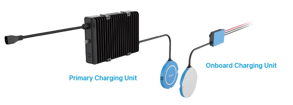

Delta, a global provider of power and thermal management solutions, introduces the brand new Wireless Charging System MOOVair Series - an innovative industrial charging solution for automated electric-driven vehicles. The newly presented MOOVair 1 kW Wireless Charging System offers up to 1 kW contactless, high efficient charging for all types of 24 V / 48 V batteries, and is suitable for automated e-vehicles that require a frequent battery charge.
The 1 kW Wireless Charging System features a 1,000 W output, peak efficiency of 93%, and power transmitted over a gap of up to 20 mm. It is made of two parts: a transmitter connected to the AC supply as primary charging unit and an onboard charging unit connected to the battery. The onboard charging unit is available in versions suitable for 24 V or 48 V batteries, and multiple onboard units of either variant can share one transmitter pad saving space and cost. The onboard charging unit is compact (168 x 82 x 28 mm) and lightweight (1.5 kg, onboard charging pad included), making it simple to place inside even small e-vehicles. With the charging pads protected against water and dust to IP65, and a robust design for shock and vibration, the MOOVair Series has reliable performance even in harsh industrial environments.
