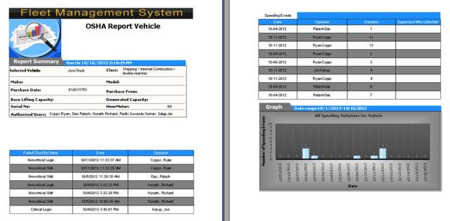

If there is an accident or an OSHA infraction you can generate reports instantly on vehicle and operator usage, impact and speeding events and a history of failed checklists by that vehicle so the inspector gets quick information about the usage of the machine and driving habits of the operator.

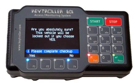

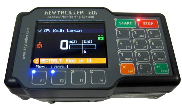

  • Driver logs into the device with valid code or RFID card
  • If it is the first start of the shift, the driver must complete electronic checklist
  • Checklist is completely programmable through wireless software connection
  • Each item can be designated for daily, weekly or monthly completion
  • Any checklist item can be flagged designating it a critical item

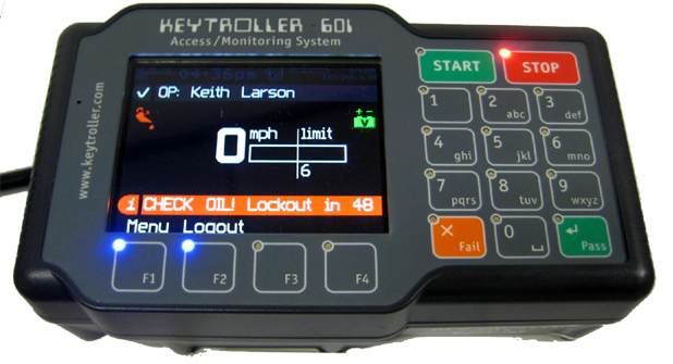

  • If a flagged (critical) item is FAILED by the operator the display warns him the unit will shut down
  • After shut down, a supervisor or mechanic only can re-enable the device

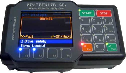

  • Driver presses PASS or FAIL for each item
  • If FAIL is presses for a non-critical (non-flagged) item---the event will be recorded in the log
  • Device is programmed to give the operator X# of minutes to complete the checklist
  • When device gets within 1 minute of checklist period, the device "counts down" on the display
  • If the checklist is NOT completed within the allotted time, the device will shut down
  • Operator can again re-start, however, unfinished checklist must still be completed
  • After completion of the checklist, the driver presses START to start the vehicle from the keypad
  • Recent events are stored on the keypad device where a supervisor can view failed checklist items
