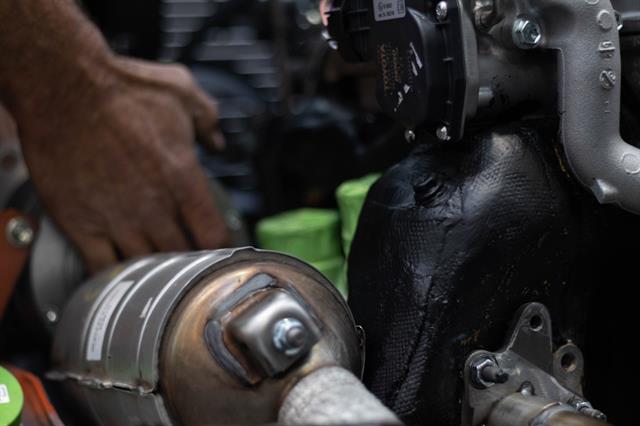

To allow these machines to work safely in Atex zones and to keep their original rating unchanged, two main macro-themes are highlighted here among the actions implemented by Miretti: the control of the heat rejection and the interception of the time at which regeneration of the particle filter is to take place. The results obtained are confirming the validity of the solutions undertaken.

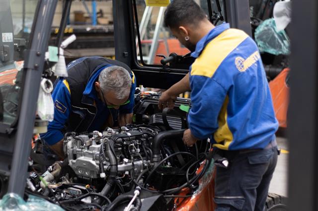

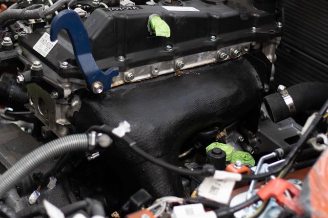

During the explosion-proof conversion phases, thermal tests are carried out on all the hot spots of the truck to verify and customize the technical solution adopted also on the basis of the specific needs of the machine and any problems detected. The original components of the exhaust line are preserved, without the need to replace them. The CoatEx system, patented by Miretti, represents one of the solutions adopted to limit the surface temperatures and allowing to stay below the critical temperatures required by the conversion. CoatEx does not intervene on the functionality of the original exhaust line, maintaining a high level of safety of the engine itself.
As regarding, instead, the regeneration of the DPF filter, we started from three considerations: in order to continue to break down the particulate matter correctly and maintain the original stage, the machine must be able to regenerate the particulate filter, the regeneration must necessarily take place in an area not classified, the Atex machine must operate in safety. The after-treatment systems, mounted on handling vehicles, are now advanced and allow you to monitor the saturation of the filter by planning its regeneration. In response to this situation, Miretti applies a safety system which inhibits the automatic regeneration of the filter and allows this necessary operation to be carried out when the truck is in an area not classified as Atex.
