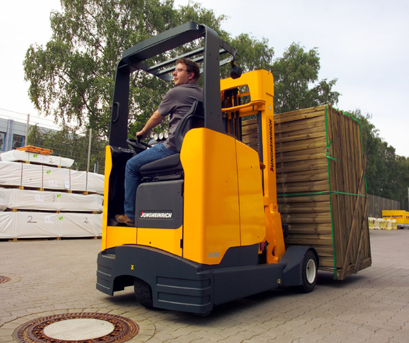

At CeMAT 2005 in Hannover, Germany, this year, Jungheinrich presented a reach truck that could be used indoors and outdoors. Reach trucks are typically unsuitable for driving outside the warehouse but Jungheinrich's ETVC series are not typical.
"Normal reach trucks are not suited to driving outside. They can go over a ramp perhaps at most once a day but when you go over ramps again and again, there need to be adjustments to the trucks," Peter Trimp said.
Part of the reason the forklifts could work outside, was its "super elastic tyres" but the tyres also resulted in a compromise in the reach truck.
"A normal reach truck has really hard wheels, so the truck is very stable. But the C-version (ETVC series) has rubber tyres that are not as solid as a normal reach truck's tyres. Hence the C-version truck can't lift as high as a normal truck. The ETVC20 can lift up to 7,400mm (7.4 metres) while an ETV20 can lift up to almost 13,000mm (13 metres)," Trimp said.
The Jungheinrich ETV C20 reach truck.
The ETVC reach truck's lower lift height makes it appropriate for customers with small-to-medium-sized warehouses that would benefit from using the same truck to load and unload vans and trucks and stack pallets indoors.
"For larger warehouses that stack pallets higher [than 7,400mm], the C-version is unsuitable. Moreover, large warehouses in the Netherlands have loading docks so the trucks never go outside," Trimp said.
Customers of the C-version reach stackers include a Netherlands seed producer and an ink manufacturer, neither of which Trimp would name. The ETVC reach trucks are available in 1,600kg and 2,000kg load capacities.

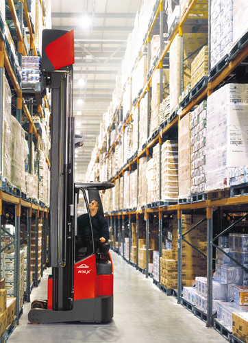

Linde puts battery below
The new X range Linde reach truck.
For Linde Material Handling, the basic design of its reach trucks had remained conventional for more than 50 years, until this year when Linde Material Handling (UK) developed what it says is a "new revolutionary truck design". The Linde X range was presented at CeMAT 2005 and Linde expects to gain market share from the new range.
Heike Oder told Forkliftaction.com News that Linde customers were primarily looking for "excellent ergonomics" in reach trucks, so it is not surprising that the new reach truck has been designed with operator comfort and safety in mind.
"High comfort and safety for the driver gives him the chance to be as productive as possible. Customers also look for high performance so load handling cycles can be executed much faster. Visibility and high stability of the mast plus fast battery changes are important too," Oder said.
The RX14-RX17 models with load capacities ranging from 1,400kg to 1,700kg have batteries located under the operator's seat and the mast permanently fixed to the chassis. The battery's new position allows the truck's designers to add operator comfort to the forklift.
The cab compartment is now twice as spacious leaving lots of elbowroom for the operator. The added space has made it possible for Linde to equip the truck with an extra wide full-suspension seat fitted with wide, adjustable armrests on both sides in which controls are integrated.
Linde says operator safety has been enhanced by moving the cab compartment inward to ensure the operator stays fully inside the truck at all times, with less exposure to injury.
The new mast design is also "inseparably associated" with the battery under the seat. The operator's seat is upraised and allows the operator improved visibility through the widely spaced mast uprights. In the new position, the operator sits closer to the mast and has a better view. The operator's view is not obstructed by hose lines, chains or hyrdraulic jacks.
Linde says the low-slung battery in a central position on the truck and the chassis-mounted mast add to the structural strength of the reach truck.
"The ballasting effect of the mast and the lower centre of gravity resulting from the position of the battery combine to give impressive stability and residual capacity throughout the load handling cycle. This adds more working precision and safety, improved further by minimal deflection of the mast that is noticeable when stacking or retrieving loads at heights of eight metres and more," a Linde statement said.
Linde claims the new mast design reduces up to 73 per cent of reach motions and increases productivity by 15 per cent, compared to conventional reach trucks.
The maximum lift height of the R14X is 9,500 mm (9.5 metres) while the R16X and R17X models can lift up to 11,500 mm (11.5 metres). The truck's maximum speed is 14km/h and it lifts loads at a maximum speed of 0.7m/s.
