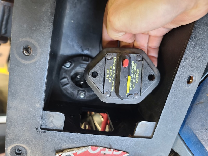

Obviously i know the "right" answer is to just call Toyota and make it their problem but I would like to see if a new breaker/disconnect fixes the issue. Im talking about the red button inside of the cable storage cubby that cuts battery power. I removed the switch, tested, and got spotty continuity while it was open. Tested a good unit to double check and got no continuity while it was open.
The battery has no lights, doesnt charge, and doesnt turn on. I assume the breaker failed, but would that damage anything else? Normally breakers are meant to break the flow even if they fail, but the spotty continuity while open is the main reason im asking for help/info here. I assume theres other safety features inside the battery so it wont explode or anything if i put a new breaker in and it also fails partially closed?
