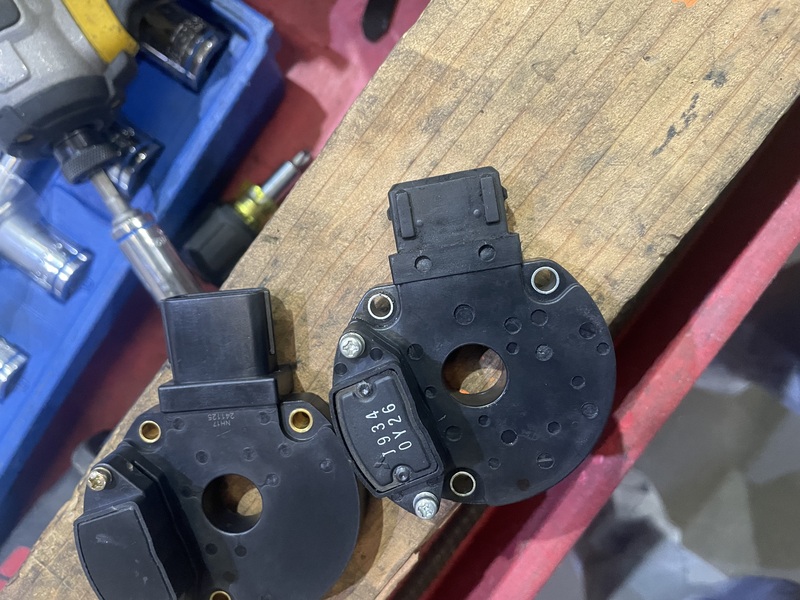

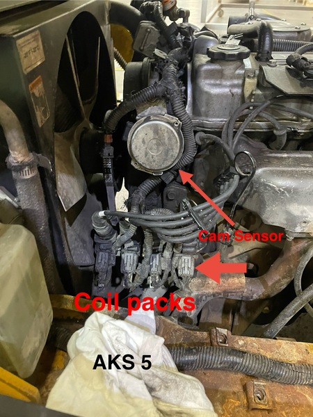

I have a YALE FORKLIFT model GLC050VXNVRE083.i have the MAZDA 2.2L engine. It was working fine and the next day after the service it will not start. I have checked the timing belt, good. All fuses and relays, good. Then I checked for spark, none. Mine has no distributor. It has coil packs for each spark plug and a cam sensor. I found the module for the cam sensor on AMAZON bought it and replaced it, no spark. Has anyone had this issue and can help me out? Thank you
