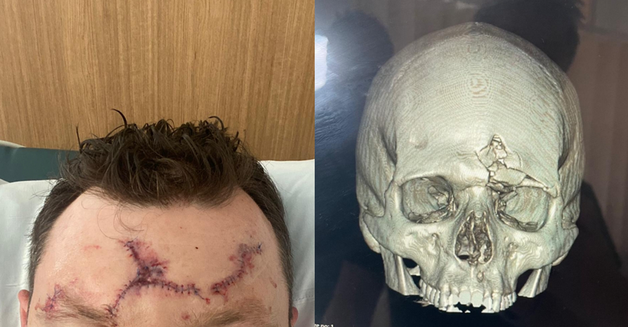

ICHCA refers to a 2023 incident in which a team leader at a terminal was struck by a falling twistlock. The twistlock had become dislodged because the twistlock locator pin failed while loading into a blind cell on deck.
Luckily the man was wearing head protection which likely saved his life.
