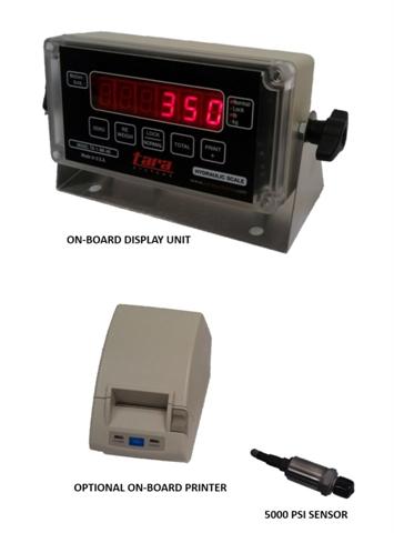

The TR-1-NK-HE weighing system. Click for larger view
The TR-1-NK-HE hydraulic digital forklift and loader scale is a full feature, cost efficient weighing system. Easy to install and attaches to any type of hydraulic lifting system by converting hydraulic pressures to a readable weight display. View the weight of the load on-board reducing the risk of unsafe loads and increasing productivity. System is made in the USA and comes with a 1 year manufacture warranty.

The model TR-1-NK-HE digital scale indicator is supplied with a 5000 psi (temperature compensated) sensor with 12 feet of hook-up cable to the digital display. The unit provides a quick and easy weight check. It has a "Lock-on-Weight" feature that keeps the weight on the display while pressure may be bleeding in the lifting cylinder.
APPLICATIONS:
  • Attach to any type of hydraulic lifting systems to view the weight of the load being lifted.
  • Accuracy error 1-2% of lifts capacity.
  • Use on forklifts, loaders, and similar machines.
  • Converts hydraulic pressures to readable weight display.
  • Quick and easy weight check for shipping, receiving, inventory verification, etc.
FEATURES:
  • The scales capacity has no limit and will be the same as the loaders capacity.
  • Graduation: 10 lbs. up to 10,000 lbs; 50 lbs over 10,000 lbs
  • Power 12 to 48 volts DC with reverse polarity protection
  • All pushbutton controls.
  • Overload warning.
  • Weight TOTALIZATION feature allows for accumulation when loading or unloading.
  • Display modes for "Lock-on-Weight" or "Static weight".
  • Adjustable motion detection and threshold for "Lock-on-Weight".
  • Reweigh button for "Lock-on-Weight" without reloading the scale.
  • Adjustable sample rate.
  • Water-resistant corrosion proof enclosure with stainless steel adjustable stand/mount.
  • Lock-on-Weight for stable viewing and totaling of weight.
  • 5000 PSI (temperature compensated) sensor. For harsh environments and extreme temperatures.
  • Full range push button zero.
  • Each weight can be stored and totaled.
  • High efficient super bright LED 6 digits .56" high.
  • Enclosure ABS sealed 6.5" by 3.5" by 2.25" (without stand).
    Data output for optional printer or computer.
  • Display mounted for easy viewing and operation without interfering with the operators view.
  • The standard features provide for easy setup and calibration and a simple interface to optional printers or computers.
  • Ability to weigh while loading eliminates time wasted using a stationary scale.
  • 1 year MFG WARRANTY.
HOW IT WORKS:
Installation is easy and consists of mounting the display in a convenient location, teeing in the pressure sensor, and attaching the power cord to the vehicle battery. The display is mounted for easy viewing and operation without interfering with the operators view. It gives the operator a quick check for unsafe overloads. The unit has adjustable parameters for automatic weight capture and capture and add for front-end-loaders. Display modes for display of Current Load or Total Weight, overload warning, and a super bright LED display. Add a printer for recording each load and total. Use a roll receipt printer to print each load and the load total. For printing labels, use our label printer for printing stick-on labels with large print characters and/or bar code information.
