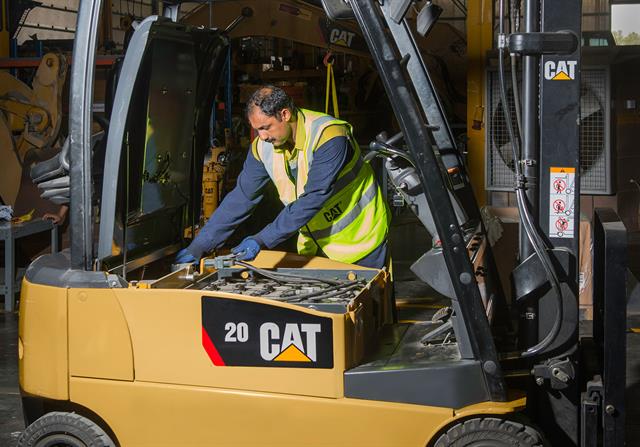

First, you need to know that not all lead-acid batteries are the same. Most forklifts use traditional flooded lead-acid, but there are alternative 'sealed' types, known as valve-regulated lead-acid (VRLA) batteries, that don't need topping up with water. Amongst those are some advanced ones which take lead-acid capabilities to new levels. Li-ion batteries, which require a sophisticated battery management system (BMS), are also sealed.
Energy efficiency
Li-ion packs tremendous energy into a small space and delivers sustained performance over long runtimes. Flooded lead-acid batteries are bulky but they're great at supplying high current for heavy duties. Apart from the more advanced models, VRLA batteries have less capacity. Energy costs are higher for lead-acid, especially in flooded batteries, as they need regular overcharging to stay healthy.
Charging and cycle life
Lead-acid packs have to be charged for several hours at a time. Recharging before they drop to about 20% of their capacity shortens their life, except for the most advanced VRLA units. These, like Li-ion batteries, can be opportunity-charged at any time - during lunch breaks, for example - without ill effects. Flooded lead-acid batteries may live a bit longer than VRLA, but not as long as Li-ion. On the downside, Li-ion batteries are harder to recycle.
Maintenance needs
Li-ion and sealed lead-acid batteries are virtually maintenance-free. For flooded lead-acid, you can extend watering intervals with the right battery and charger - or think about an automatic top-up system. Flooded batteries need a special ventilated charging room, as they produce explosive gases. When stored, their cells lose charge and must be recharged every few months. The latest VRLA advances can increase this to two years, while Li-ion holds charge even longer.
