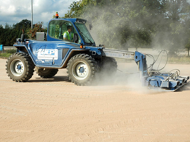

Telehandler with "whacker" attachment.

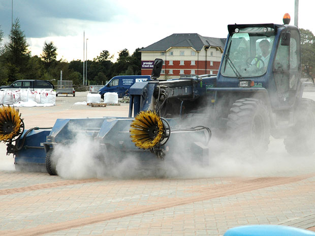

Instead of workers manually lifting individual blocks and placing them below foot level, OLP now uses a Probst laying machine, which places one square metre of paving at a time. A Merlo Panoramic P34.7 TOP model telehandler with a "whacker" attachment, made by Stehr, in Germany, is used to tamp down blocks and then, with a sweeper attachment, sweep the area after sanding.
Telehandler with sweeper attachment.
