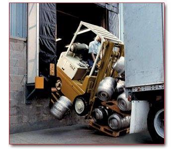

A truck leaving prematurely is the most dangerous concern, but occurs the least frequently. The circumstance often stems from poor communication between the truck driver and the dock worker who often have competing priorities, Beer notes. One worker wants to get unloaded/loaded quickly, while the other may have that task lower on a priority list.
"One best practice strategy to combat the tenuous relationship between the dock worker and truck driver is a restraint management system," Beer says. The components include a multi-level restraint strategy, a visual safe operating procedure and the dock worker having the ultimate responsibility.
A life is at stake as a forklift operator travels over the dock leveler into the truck and then backs out.
"If the driver pulls the trailer away prematurely, the dock worker is in danger," Beer notes. "So, even if the company policy is to have the truck driver set his wheel chocks, the dock worker has to manage that (and) look to make sure they are set and take appropriate action if they are not set properly."
