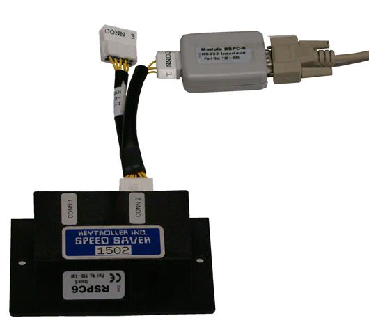

SPEED SAVER top speed controllers are designed for both---- internal combustion and electric forklifts.
SPEED SAVER top speed controllers are designed for both ----for cable type accelerators (SS-701) or electronic "fly by wire" accelerators (SSEL-701) .

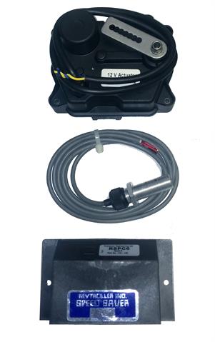

  1. Installed Keytroller SPEED-SAVER for conventional cable type throttles.
  2. LASERTROLLER laser installed on forklift overhead guard. Laser focused straight up above forklift
  3. Laser detects the presense (or absense) of the ceiling above and outputs a signal when inside the building---no signal outside the building
  4. SPEED SAVER cable controller controls top speed by actuating a cable connected to throttle lever. NOT actuate and restrict thottle cable (which restricts top speed)
    • Speed #1: No signal---device does NOT actuate---NO restriction of throttle stroke or restriction of top speed (high top speed---traveling outside the building)
    • Speed #2: Signal present----device actuates to restrict throttle stoke and control top speed (low top speed----traveling inside the building).
  5. Both SPEED SAVER models will NOT effect hydraulic lifting power needed on internal combustion engines to lift heavy loads at low (or stopped) speed.
