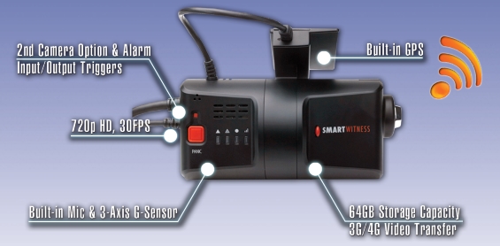

  • It is a lockable wireless camera that mounts to any make or model forklift.
  • It is available with an optional external IR "night vision" waterproof camera
  • It has a USB port for connection to optional wireless modem. (WiFi or Cellular)
  • It has built in GPS
  • It has built in impact sensors
  • It has slots for 2 (32GB SD cards)
  • It can be triggered by the KEYTROLLER LCD access monitoring device to record an abusive video "event".

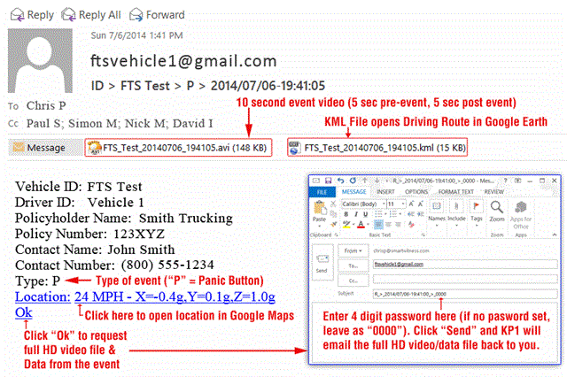

What is a video event?
  • A triggered event comes from the KEYTROLLER LCD device and would be caused by an abusive impact, an overload, a speeding over limit or a pedestrian egress.
  • When triggered, the SMARTI saves 20 seconds before the trigger and 20 seconds after the event trigger.
What happens after an abusive video event is recorded by SMARTI?
  1. This video event is stored as a separate file from the continuous video---it is not overwritten
  2. If the SMARTI has a wireless modem, a low resolution video of the 40 second event is emailed or texted out to up to 5 respondents.
  3. A supervisor receiving the video opens it on his smart phone and views the video of the abusive event unfolding before him

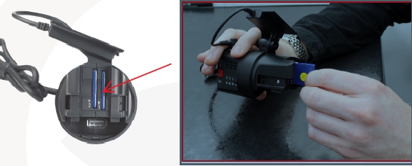

How do I view the video on the SD cards?
  • Open the front camera enclosure with key provided to prevent unauthorized access to the SD cards.
  • Remove the SD cards from the camera enclosure
  • Take the SD cards back to your PC and insert into SD card reader and insert into USB port
  • FREE software is installed on your PC---this is used to view the video content.
