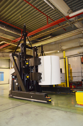

Rolls of paper weighing up to 5000 kilos are transported using Rocla's Automated Guided Vehicles (AGVs) at the Sappi Alfeld GmbH paper mill in Alfeld, south of Hanover in Germany in the Niedersachsen region. This transport system, with its total of three vehicles, was commissioned in 2011.

The AGV operating area is lit only dimly, thereby saving on additional costs. No additional light source is required for operation of the AGVs. The vehicles find their way around by means of the reflectors secured to the walls and supporting beams in the warehouse. A rotating laser detects the distances to the reflectors and calculates its position by means of triangulation.

Rocla AGVs are very stable and can carry a load of up to five tonnes.

One significant aspect is the safety offered by the AGVs. "We have had no accidents with the vehicles to date," says Manfred Rohling, standing in front of one of machines to demonstrate. With this, he shows how the vehicles recognice their surroundings and detect obstacles promptly: the vehicle comes to a standstill five centimetres away from his foot. When its route is clear again, continues on its journey.
The routes of these driverless transport vehicles are stored on each individual vehicle. Transport logic calculates the optimum route for a transport job, taking into account the origin, the destination and the position and status of each individual vehicle in the system. If another vehicle blocks the optimum route unexpectedly, an alternative route is selected.
