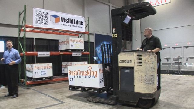

Rush Tracking Systems demonstrated its VisiblEdge radio frequency identification (RFID) solution during a trade show in Orlando, Florida.
The demos gave attendees a chance to "see, touch and interact" with real-world solutions, says Toby Rush, president and chief executive officer of Lenexa-based Rush Tracking Systems.

For the demonstrations, the Rush team mounted its equipment on a seasoned 2002-model Crown SC 4540 sitdown rider forklift with more than 8,000 hours of service time. Trade show services provider Champion Exposition Services, of Middleboro, Massachusetts, obtained the rented, battery-powered 4,000-lb (1,800-kg) capacity forklift through heavy construction equipment rental and leasing firm Southern Boom & Scissor Inc, in Orlando.
When making its own equipment arrangements for other events, Rush Tracking Systems usually uses materials-handling equipment from Raymond Corp, of Greene, New York.
Rush can mount the VisiblEdge solution on any class 2 or 3 forklift, using clamps or heavy-duty magnets, or structural attachments for more permanent mounting.
In March, Rush Tracking Systems released the Orchestrator software module in its VisiblEdge platform. Orchestrator integrates with existing warehouse management system and enterprise resource planning applications to streamline distributing and executing work instructions for forklift operators.
In the Orlando demonstrations, a forklift operator received a pallet of goods in a warehouse setting, automatically captured a pallet's location within a bulk-storage receiving area, used Orchestrator to find a product-picking location and illustrated asset use and optimisation of labour standards.
