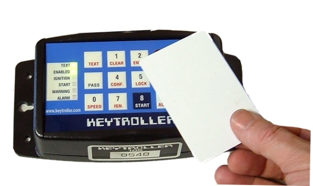

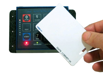

  1. Driver passes his RFID card over the keypad "scanning field"
  2. Card reader under the keypad detects and "wakes up" the RFID chip in the card/FOB
  3. The card/fob transmits the ID information on its microchip and is "read" by the device
  4. If it is a valid ID card for that device and vehicle, the unit will enable---allowing trained operator to start
  5. If it is an invalid ID in the card, the device will NOT allow access If enabled, the driver presses START button to start the engine (keys are eliminated)

HID Prox manufactured by HID Corp (www.hidglobal.com) is by far the most common in use in industrial applications today. Keytroller offers readers for both the HID Prox and the HID I Class type card.
How can I tell what type of RFID card is in use?
Most HID type cards have HID imprinted or embosses on the card or FOB surface. If not, you can send one of your cards to KEYTROLLER for evaluation. If the card can not be read by the KEYTROLLER device, the client can always affix an adhesive wafer to the card which can be read by the device.

  1. CARD: Credit card sized, it includes a wound antenna and chip within the card itself
  2. ADHESIVE TAG: Designed to "turn" a common plastic card into an RFID enabled card. About the size of a quarter coin
  3. FOB: Keychain style about the size of a thumb
How many KEYTROLLER models are available with RFID card readers?
LCD-601: KEYTROLLER Top of the line WiFi color access monitoring system
KEY-105: KEYTROLLER "Mid range" access monitoring system, radios optional
SSD-215: START-SMART Entry level keyless ignition
