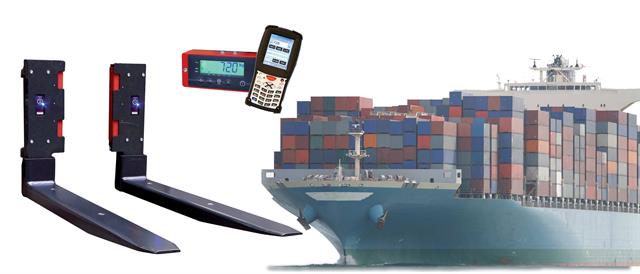

iForks weigh individual shipments early in the chain

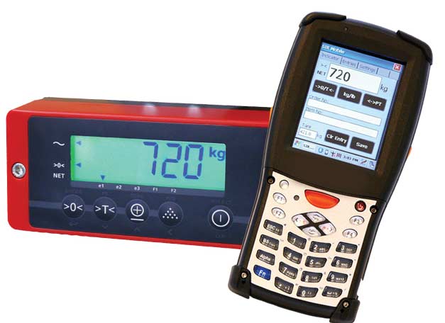

iForks is the successful wireless mobile scale for forklift trucks from RAVAS. With iForks on the truck, every load lifted is immediately weighed. iForks provide a highly accurate weight read-out in 1 kg steps on a display in the cabin, and are available in legal for trade version OIML III. Extended scale functions include registering of ID codes with every weight recorded. iForks also communicate bi-directionally with WMS or ERP systems, via Bluetooth or Wifi connection. iForks can be installed on any counterbalanced or reach truck in a matter of minutes.
iForks provide complete flexibility in the logistic chain. Individual pallets or shipments can be weighed on the forklift while packing the container, computing the container weight on the fly. But the weight of these pallets or shipments can also be sampled earlier in the chain, for example when offloading an incoming shipment from a freight truck, feeding individual weights into a WMS or ERP system that then computes the container weight when compiling its loading list. Weighing early provides many advantages: information becomes available earlier, allowing senders that have declared incorrect pallet weights to change their freight documents without missing their ship. In the end, weighing individual shipments leads to more accurate container weights and therefore more safety at sea.

For efficient computing of container weights, RAVAS offers its SOLAS App. The App can be installed on a PDA, iPad or iPhone. After identifying the container by its number and registering its tare weight, the App allows the user to identify individual pallets or shipments and register their weight, communicated by iForks. Total container weight is computed and registered on the PDA, and can be downloaded to a PC via USB cable as a CSV file. If the App is used on an iPad or iPhone, the information can be e-mailed to the shipping company straight from the App.
