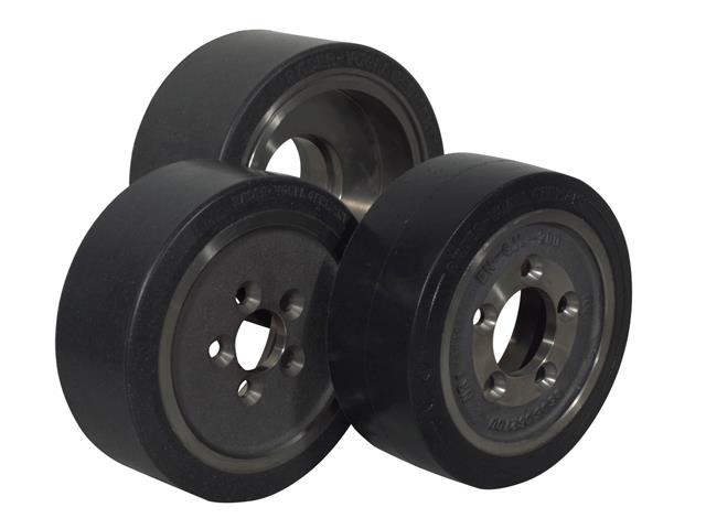

TRACTOTHAN® wheels for industrial trucks. *
Traction and wheel grip problems on trucks shuttling goods to and from deep freeze and cold store areas - especially on the drive wheels of shuttle systems and tiller-steered trucks - can be overcome by using VULKOSOFT® or TRACTOSOFT® treads with the lower shore hardness 85° Shore A. Improved traction and reduced risk of sliding lead to higher transport safety and higher output.
In mixed operations, i.e. for trucks that travel from the deep-freeze area to the loading zone or onto the ramp for truck loading, additional traction problems are caused by humidity due to condensation. Our special wet grip TRACTOTHAN® and TRACTOSOFT® treads - compounded in a patented process using a granulate with lower shore hardness - offer the acceptable solution.

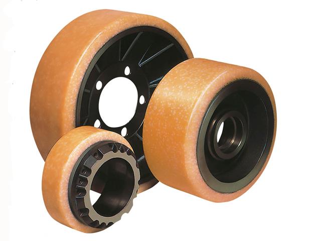

VULKOLLAN®-Quartz wheels. *
For very tough extreme corrosion/wash-down applications, e. g. in the fish, poultry, meat and dairy industries, VULKOLLAN®-QUARTZ, where silica sand is embedded in the base material, is the best, but very abrasive, alternative. It should therefore not be used on sensitive and coated floors. VULKOLLAN®-QUARTZ provides significantly improved traction on extremely humid, slippery and greasy floors and where there is a danger of icing. The shore hardness is 94° Shore A.
