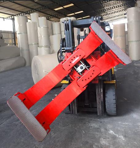

DESIGNED AND DEDICATED CLAMP: AR-RT TISSUE PAPER ROLL SERIES
The AR-RT series clamps are designed and developed to have superior visibility, great rotating speed and to be operator-friendly. Its main features:
  • Higher and wider contact pads to reduce surface pressure on the soft paper
  • Rotating paper roll clamp for vertical and horizontal roll handling
  • Arms and contact pads have smooth rounded surfaces and corners all around to reduce the possibility for the clamp damaging the roll
  • Effective and robust 180-degree rack-and-pinion rotation system. Hydraulic cushioning in the vertical end position
  • All hydraulic functions protected with built-in pressure relief valves
  • Flat spot compensation
  • Built-in pad and arm protection

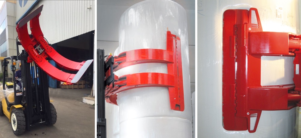

CONTACT PADS
The minimized pad thickness ensures good knifing properties when handling tightly stacked and bilge rolls and pad corners have large radius design, without protruding parts or edges.
Bolzoni Auramo knows that contact pads are the most important part of the clamp attachment. In most normal handling situations, the pads are the only parts of the clamp that actually are in contact with the paper roll. Therefore, Bolzoni Auramo has paid special attention in designing and manufacturing contact pads, which will ensure safe and non-damaging tissue roll handling. Tissue clamp contact pads have a wide area and specialized pad friction surface selected to match the operation requirements. Depending on the clamp size and application requirements, Bolzoni Auramo offers three contact pad models for tissue clamps:
  • Single Radius Pads for hard and medium-hard Tissue paper grades.
    Single radius pads are designed to match the varying roll diameters. Best suited for hard or medium-hard paper grades.
  • Triple Radius Pads for hard, medium-hard and soft Tissue paper grades, especially on larger roll diameters.
    Triple radius pads have convex upper, lower and side edges. This prevents the pad edges from cutting into the paper. These pads are suitable for all types of Tissue paper, also for medium-soft and soft paper.
  • Convex Radius Pads for very soft and hard-to-handle large diameter rolls.
    Heavy convex pads have a special form, which convexes outwards throughout the entire pad length. This enables the pad to compress the top layers of the Tissue paper roll and increase the grip. Suitable for very soft paper grades only.

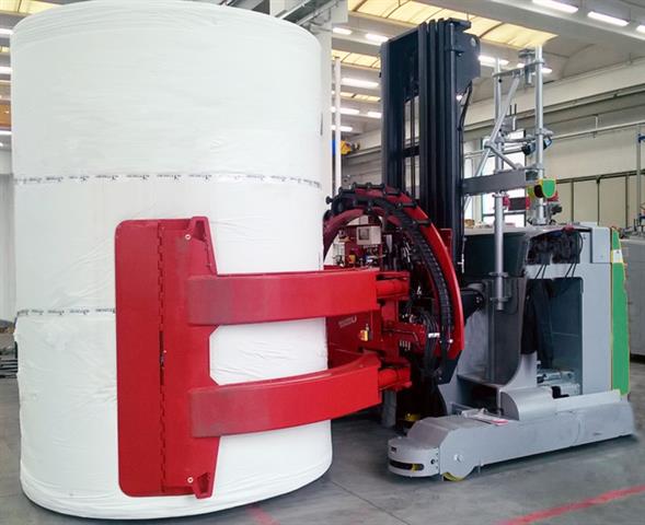

BOLZONI AURAMO IS ON THE CUTTING EDGE: PARTNER IN AGV AUTOMATED SOLUTIONS
Bolzoni Auramo Tissue paper roll clamp fitted on an AGV lift truck.
The new challenge for companies that want to embrace the Industry 4.0 philosophy is automation. Bolzoni invests in the development of products dedicated to Automated Guided Vehicles: even in the handling of tissue paper rolls Bolzoni Auramo designs dedicated equipment, with sensors managed directly from the AGV system control center.
Also, in the handling of paper rolls and pulp bales, many companies are equipping themselves with AGVs," says Paolo Chiesi, Bolzoni Italia Sales and Managing Director. ''We are in contact and cooperate with the main Italian and European AGV manufacturers, and together we design dedicated attachments".
