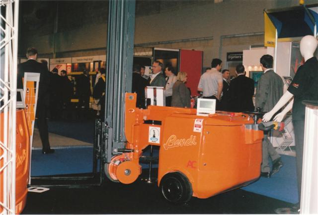

Still on forklifts, Translift Bendi chose the show to launch a number of new products. These include the mini Bendi, (a pedestrian articulated forklift), a completely reshaped B420 AC high lift model, the Bendi EU truck, which is a hybrid of the original Bendi and the traditional support arm stacker truck widely used in European markets, and the Bendi Arctic truck. The last of these has a cold store cab and joins the other two competing articulated producers, Flexi Narrow Aisle and Aisle Master. Their potential to slash high cold store construction and running costs is huge. Currently, cab-equipped reach trucks are most commonly used, but the articulated trucks will work in aisles only 1.6 m wide, a full metre less than reach trucks, while lifting loads to 12 metres or more.

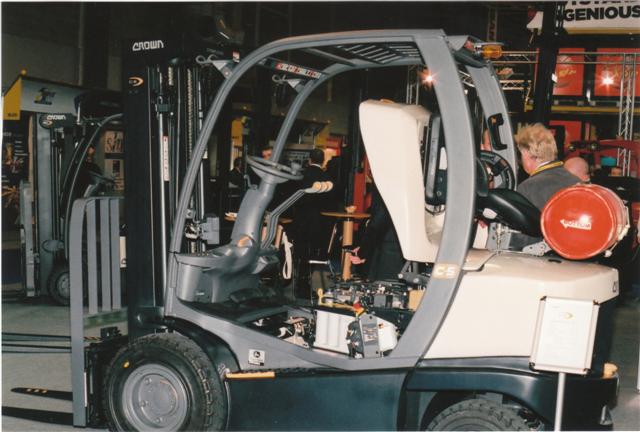

Until recently, Crown never produced its own IC forklifts, preferring instead to buy in those trucks. Now, shown for the first time is its own C-5 truck which was on show in Birmingham.

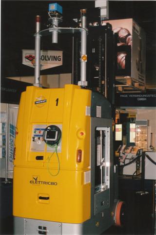

A name that does not readily spring to mind in Britain for end-of-line automation is the Italian company Elettric 80, known for its laser-guided vehicles, including its latest innovation, the Giraffe, a single pallet reach truck with an 11 metre lift. Unlike AGVs, which usually require a buried, energised wire, Elettric 80's SGVs need only small passive reflectors located within the area to be automated. This makes installation and subsequent alteration much easier and cheaper.
